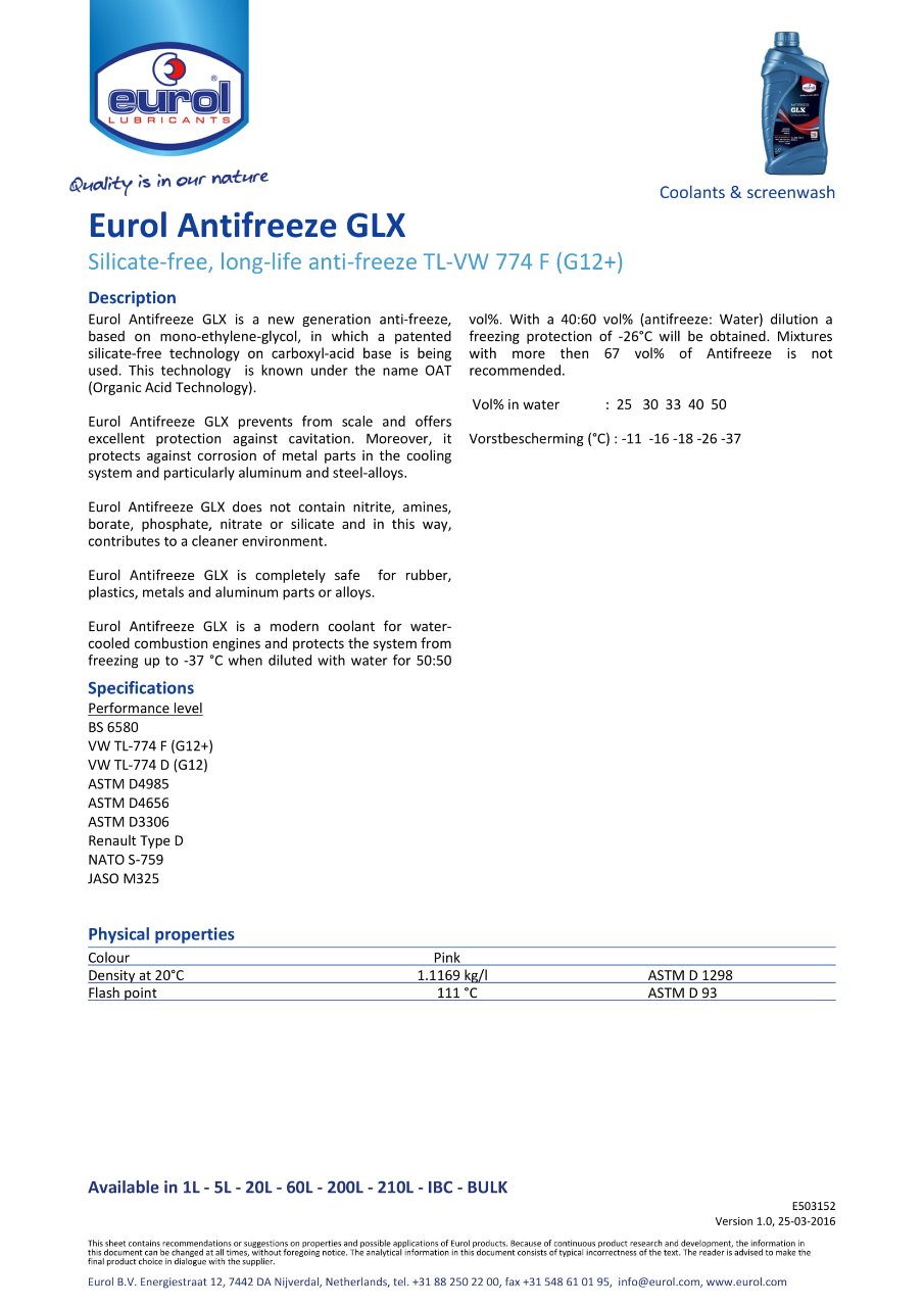

Тесты антифризов
#30
Gubkin писал(а): 18 янв 2018, 17:09Eurol CLX замерз
МЭГ при разбавлении водой 1 к 3(33% концентрата) должен замерзнуть при -18 -16.
С сайта еврол:
Eurol Antifreeze GLX is a new generation anti-freeze, based on mono-ethylene-glycol, in which a patented silicate-free technology on carboxyl-acid base is being used. This technology is known under the name OAT (Organic Acid Technology).
Eurol Antifreeze GLX is a modern coolant for water-cooled combustion engines and protects the system from freezing up to -37 °C when diluted with water for 50:50 vol%. With a 40:60 vol% (antifreeze: Water) dilution a freezing protection of -26°C will be obtained. Mixtures with more then 67 vol% of Antifreeze is not recommended.
На канистре написан, конечно, бред.
